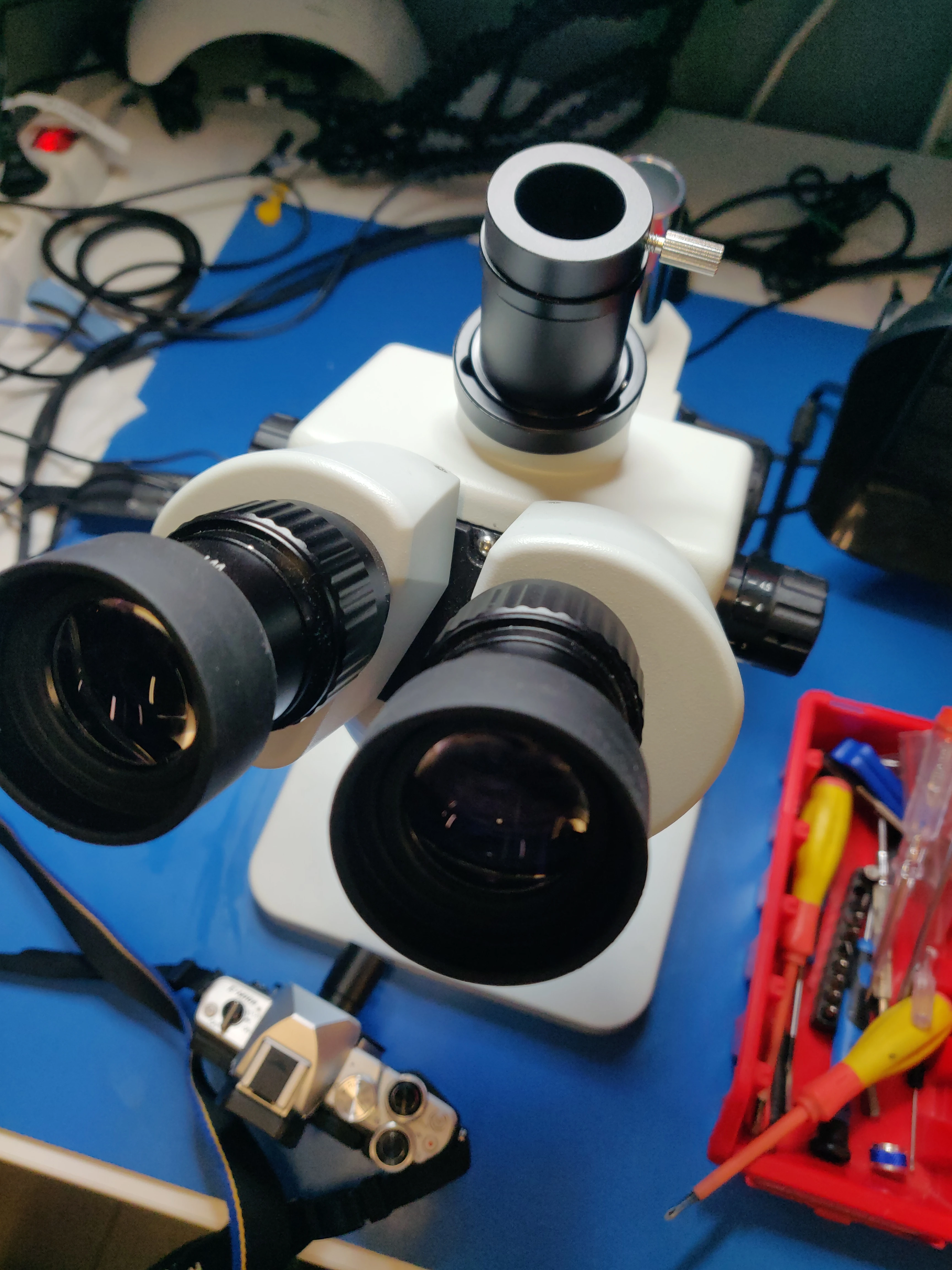

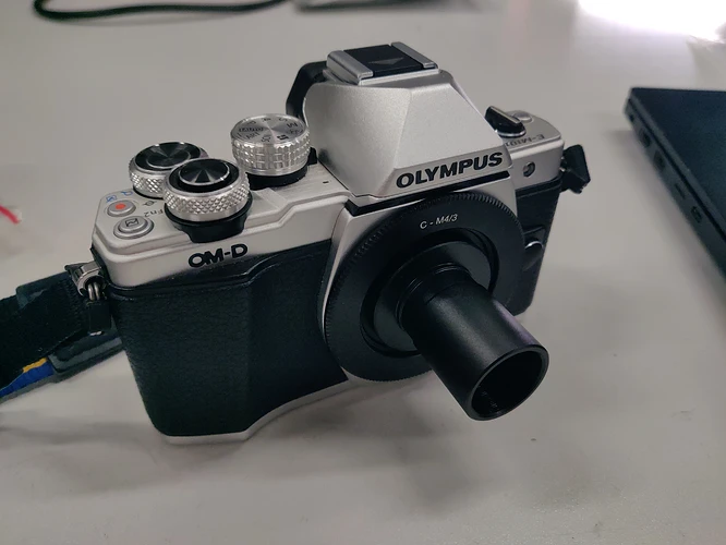

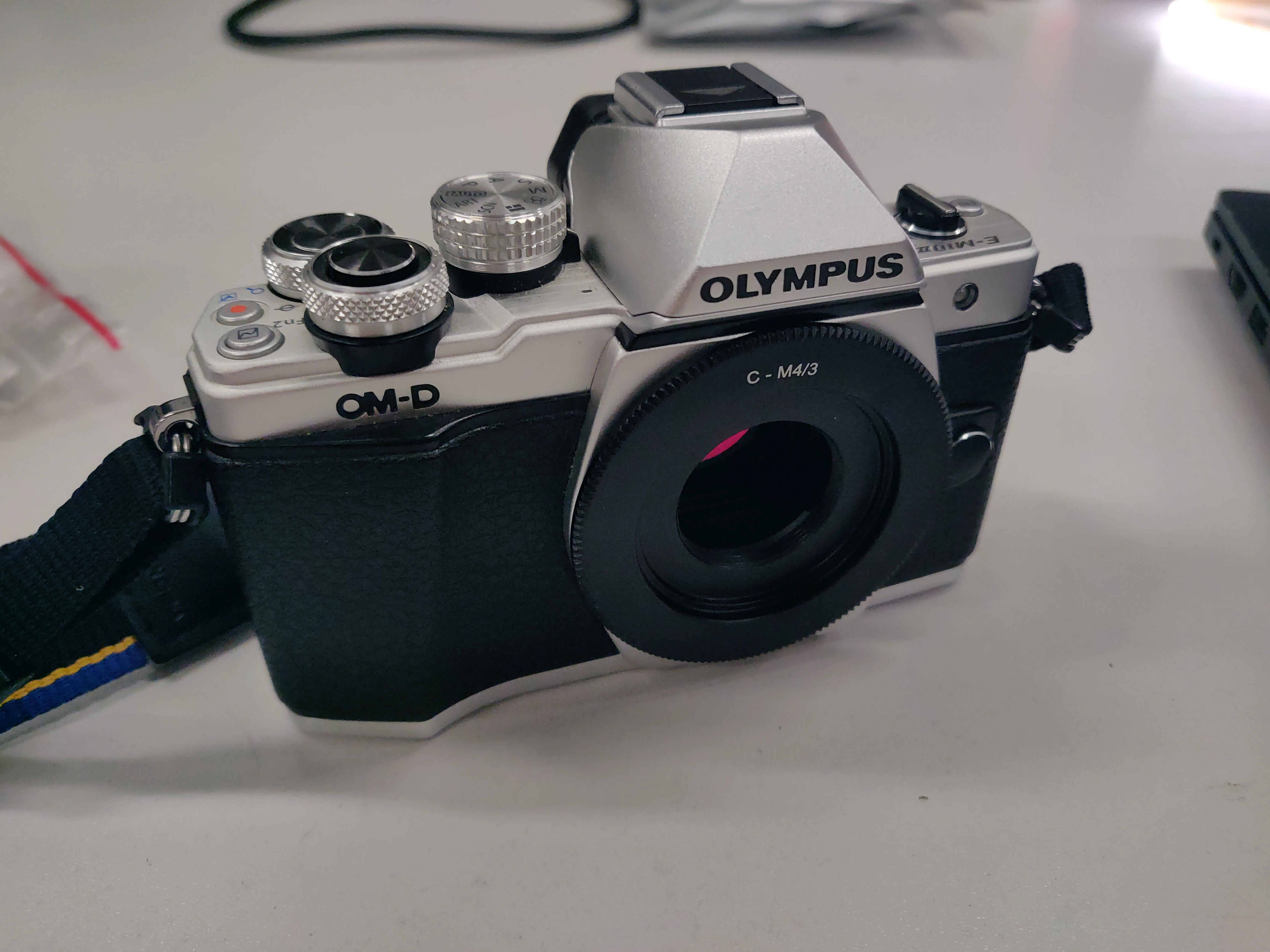

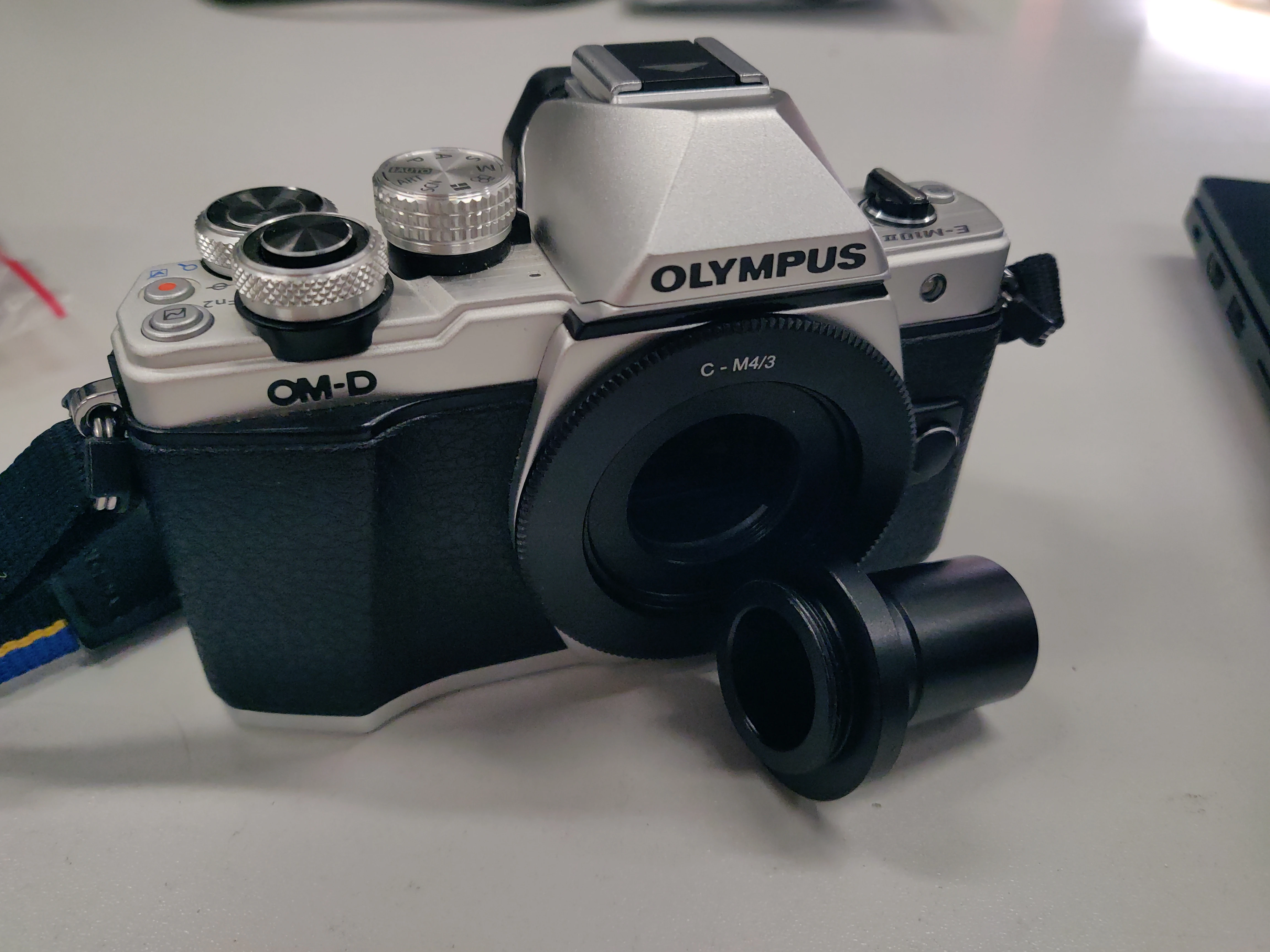

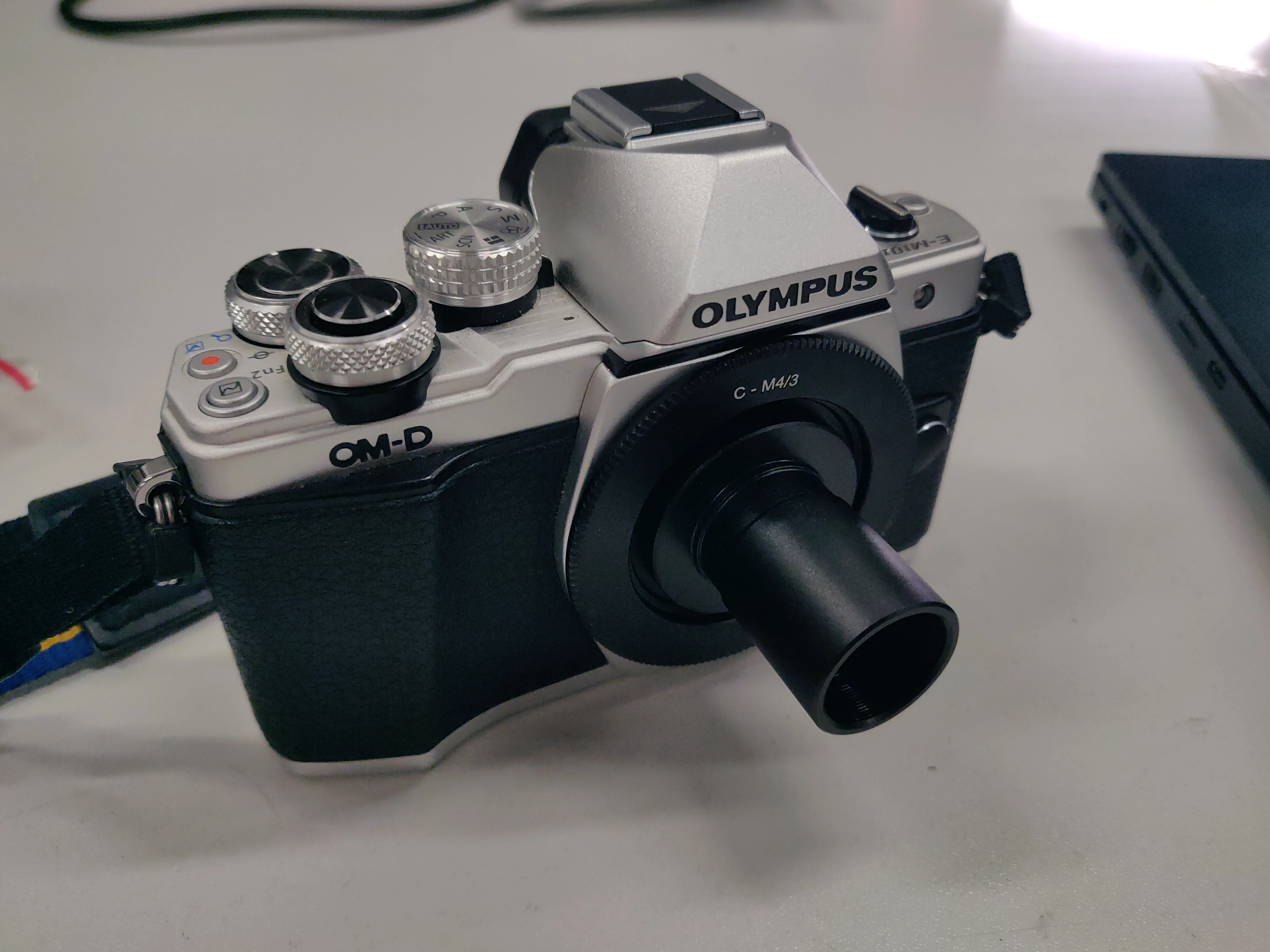

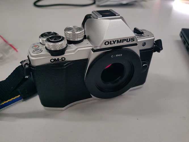

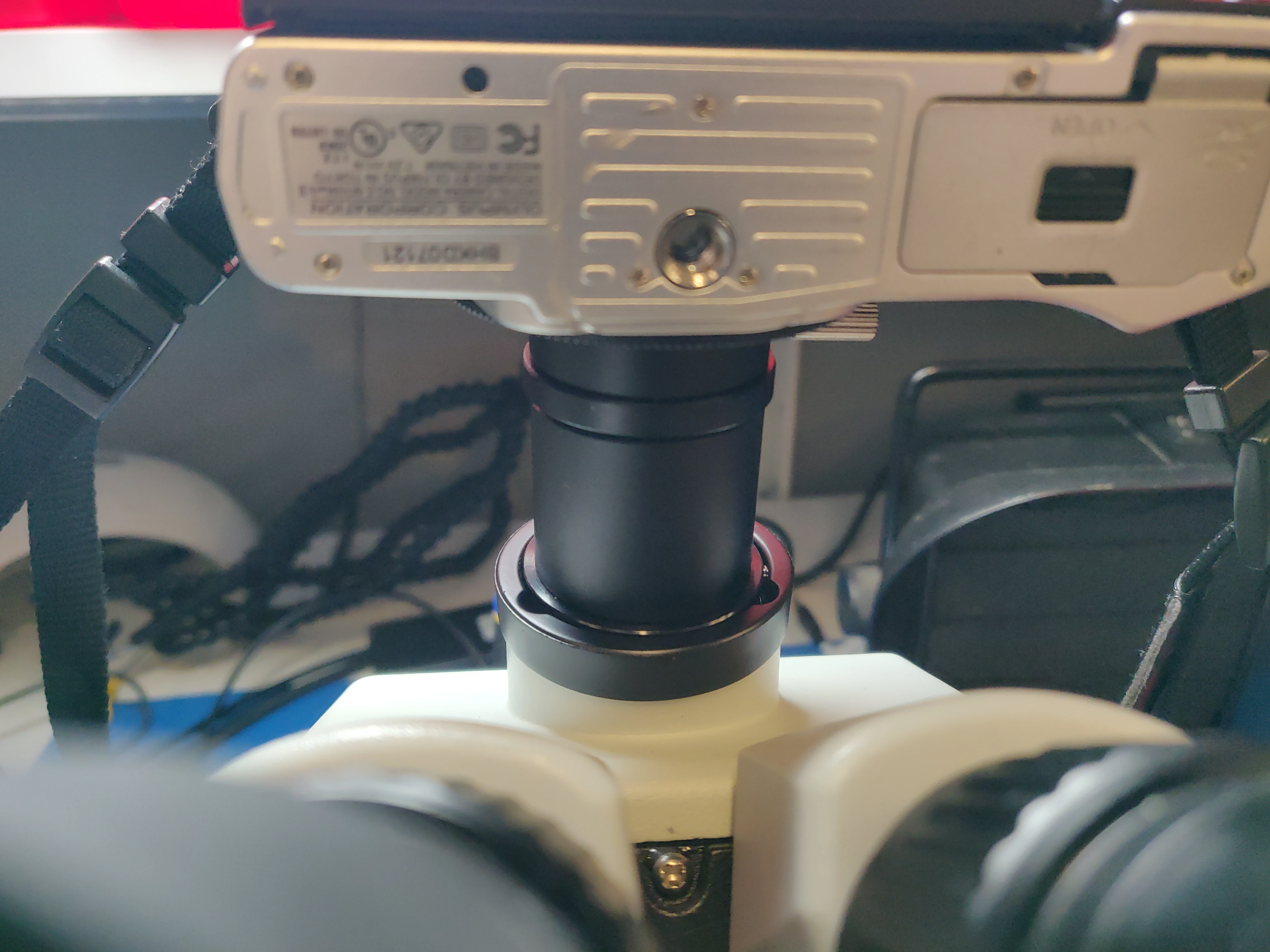

Now in the HackerSpace Wrocław we have a C-mount adapter for our microscope Mikroskop stereoskopowy.
I’ve bought the adapter on Allegro, for about 25 zł.
Here are photos how it can be used:

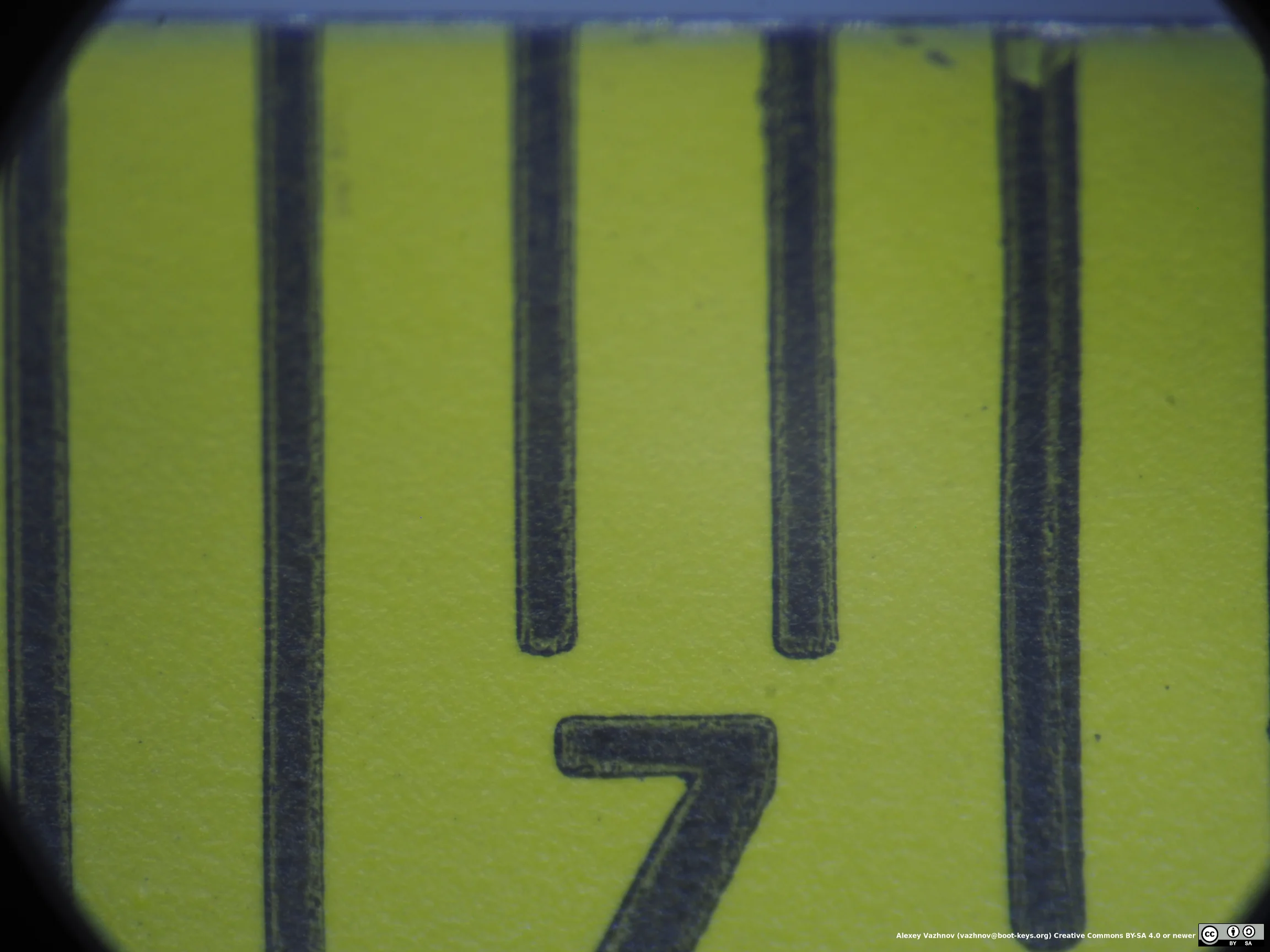

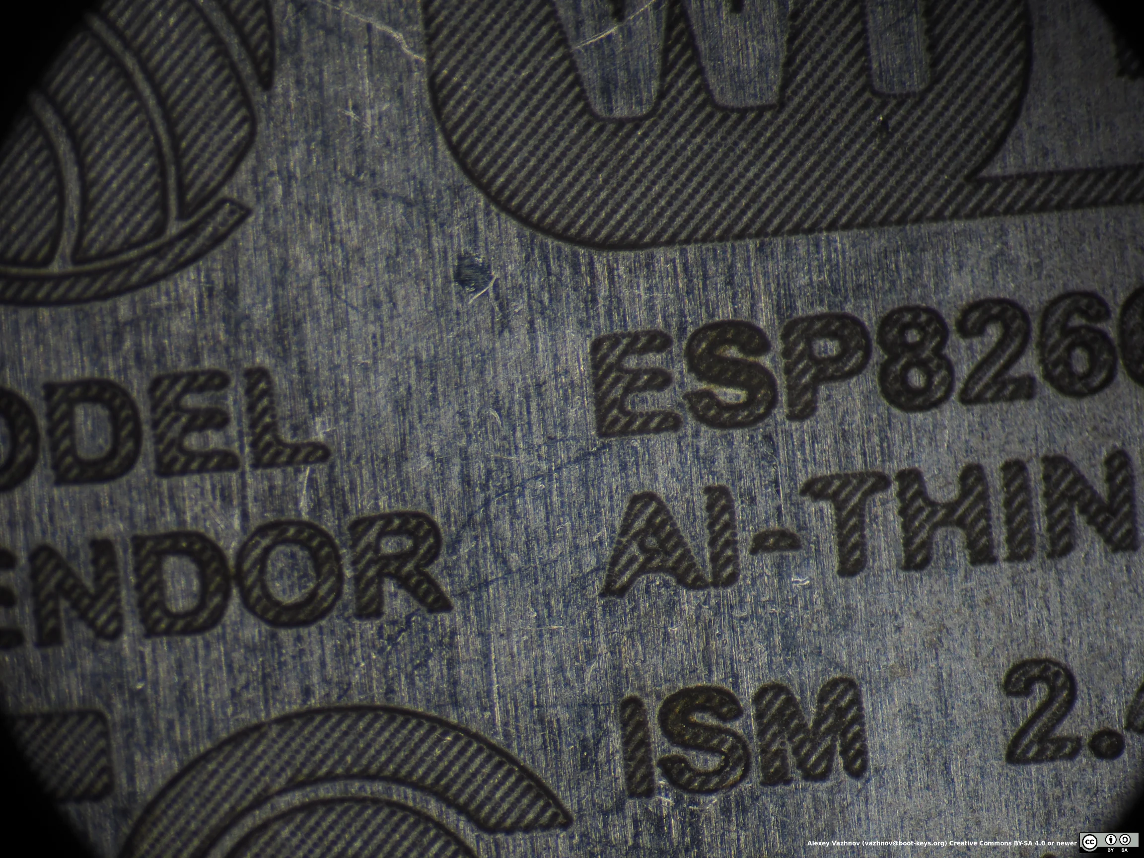

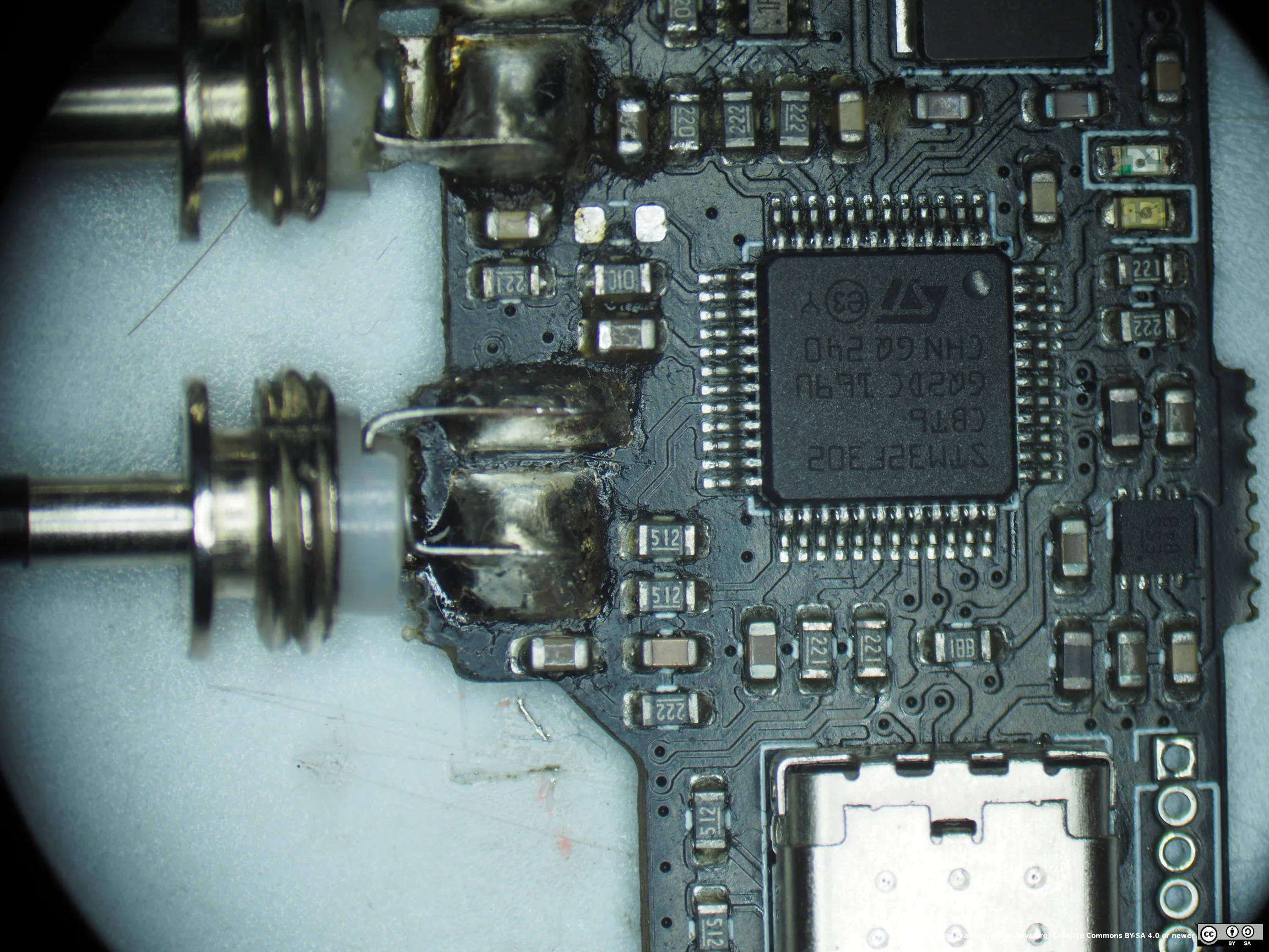

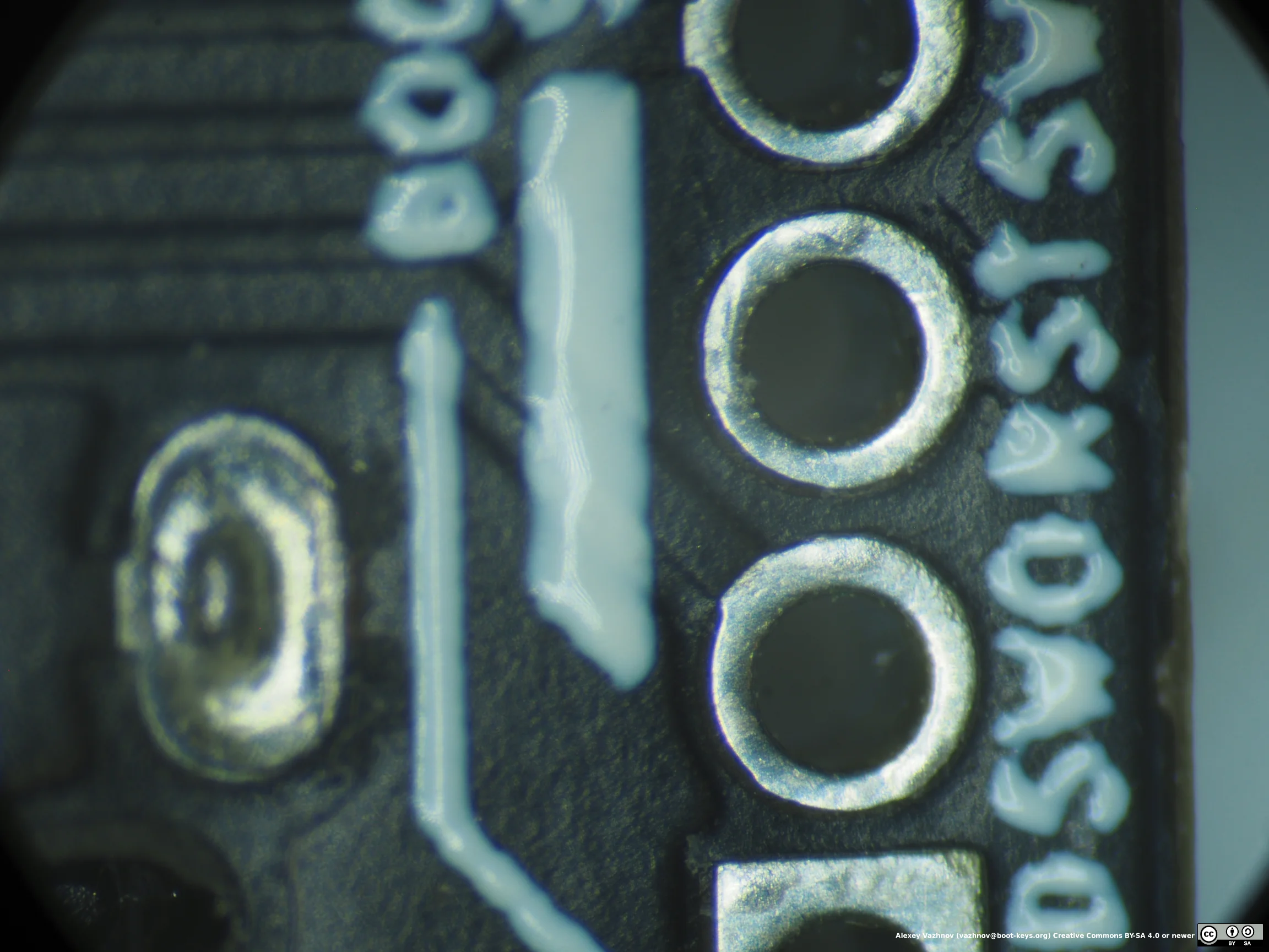

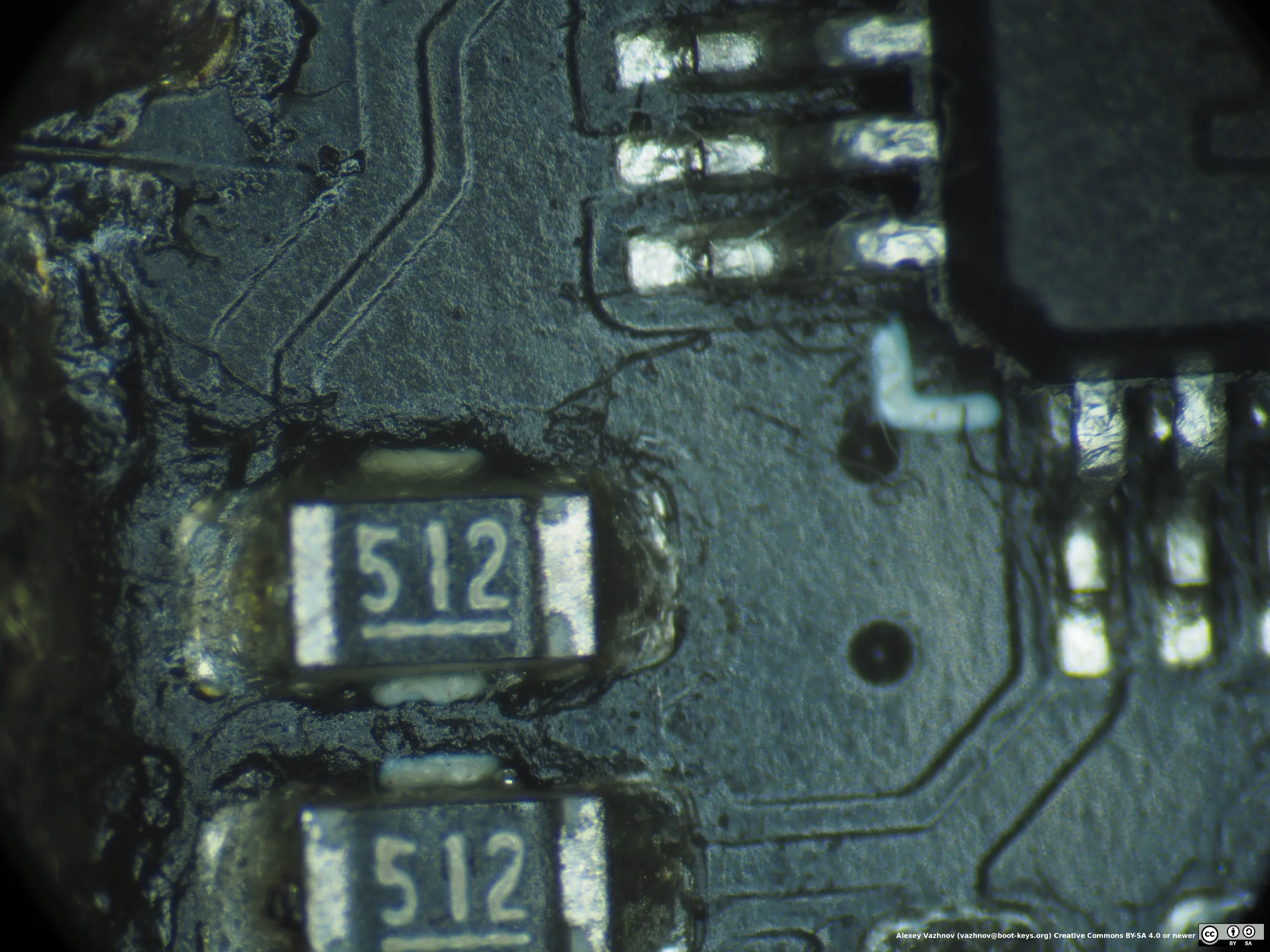

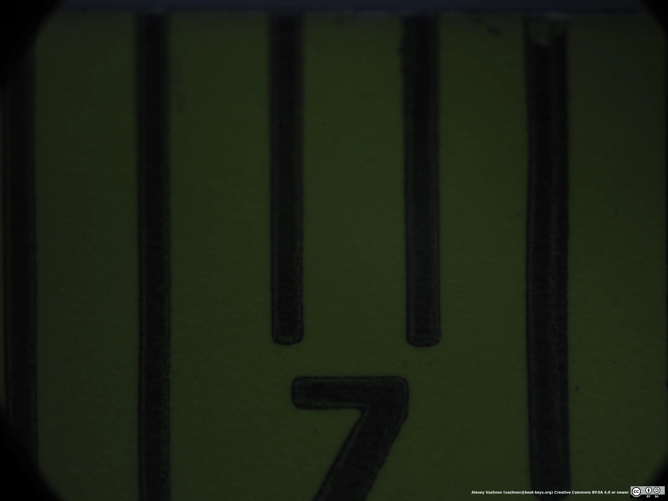

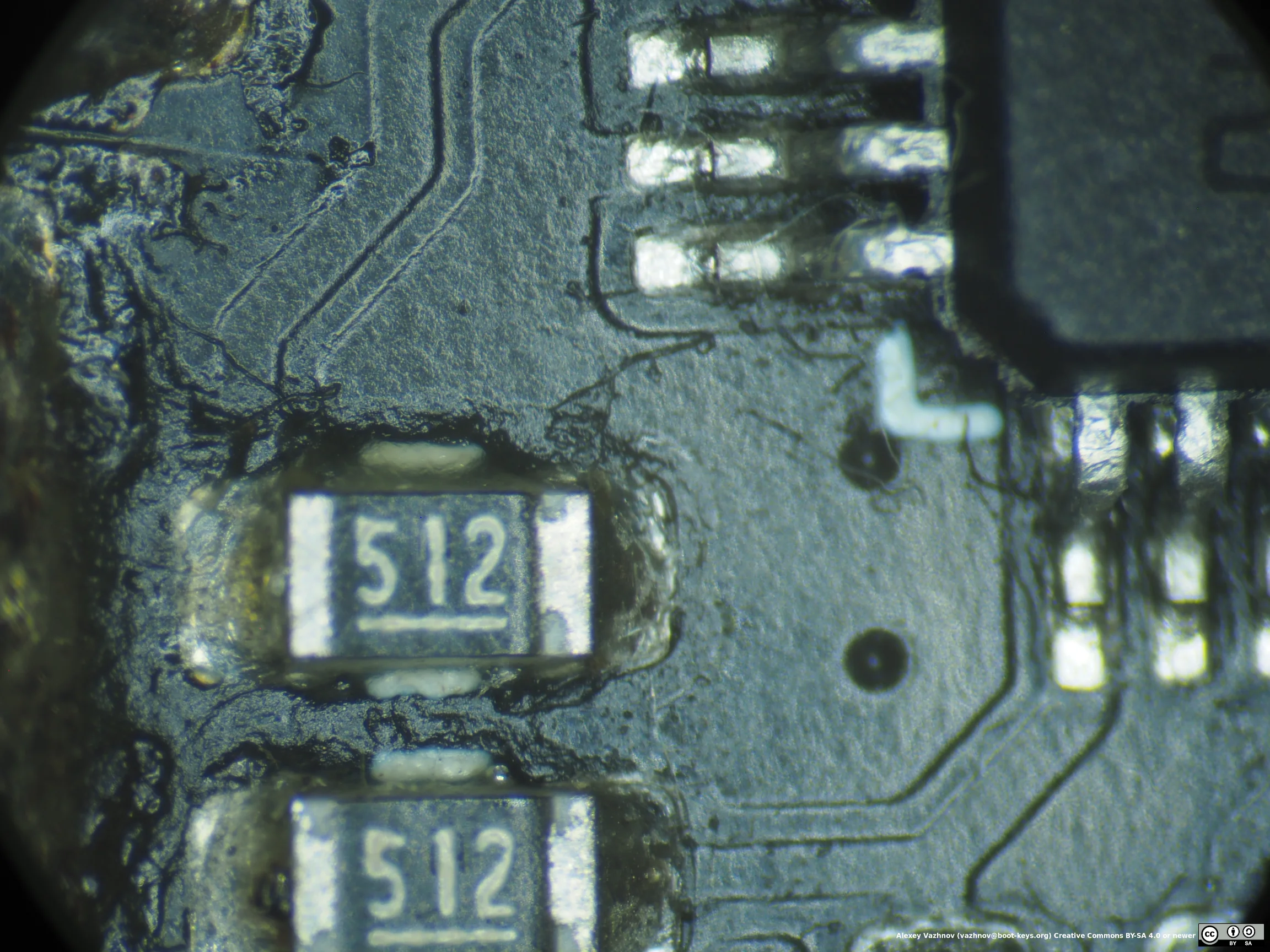

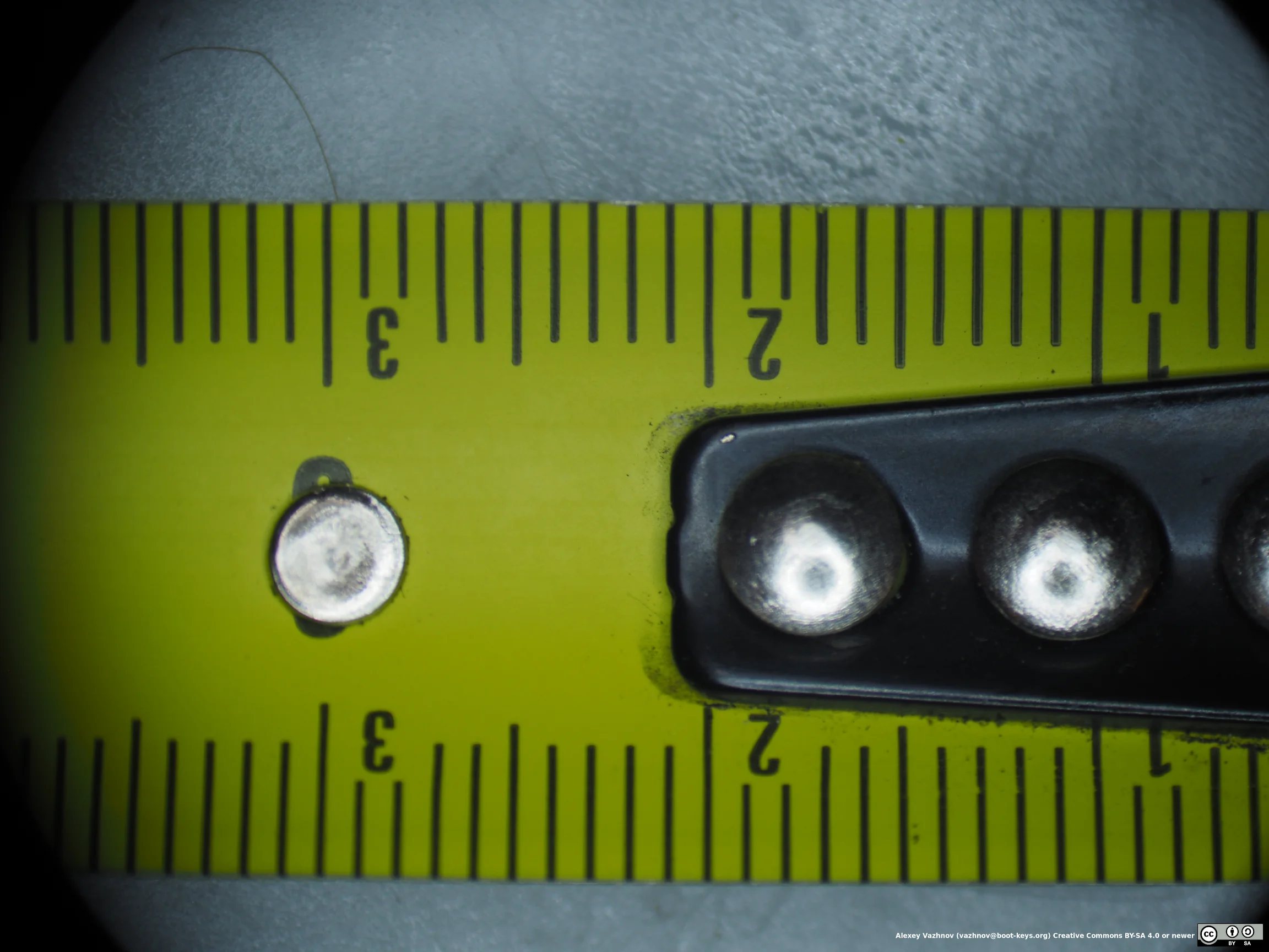

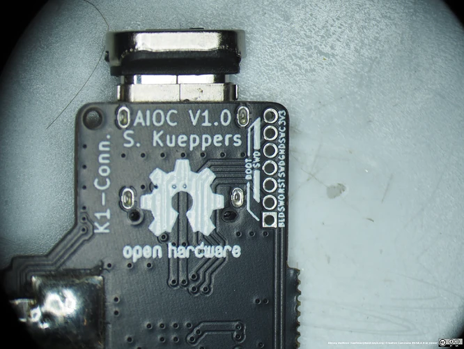

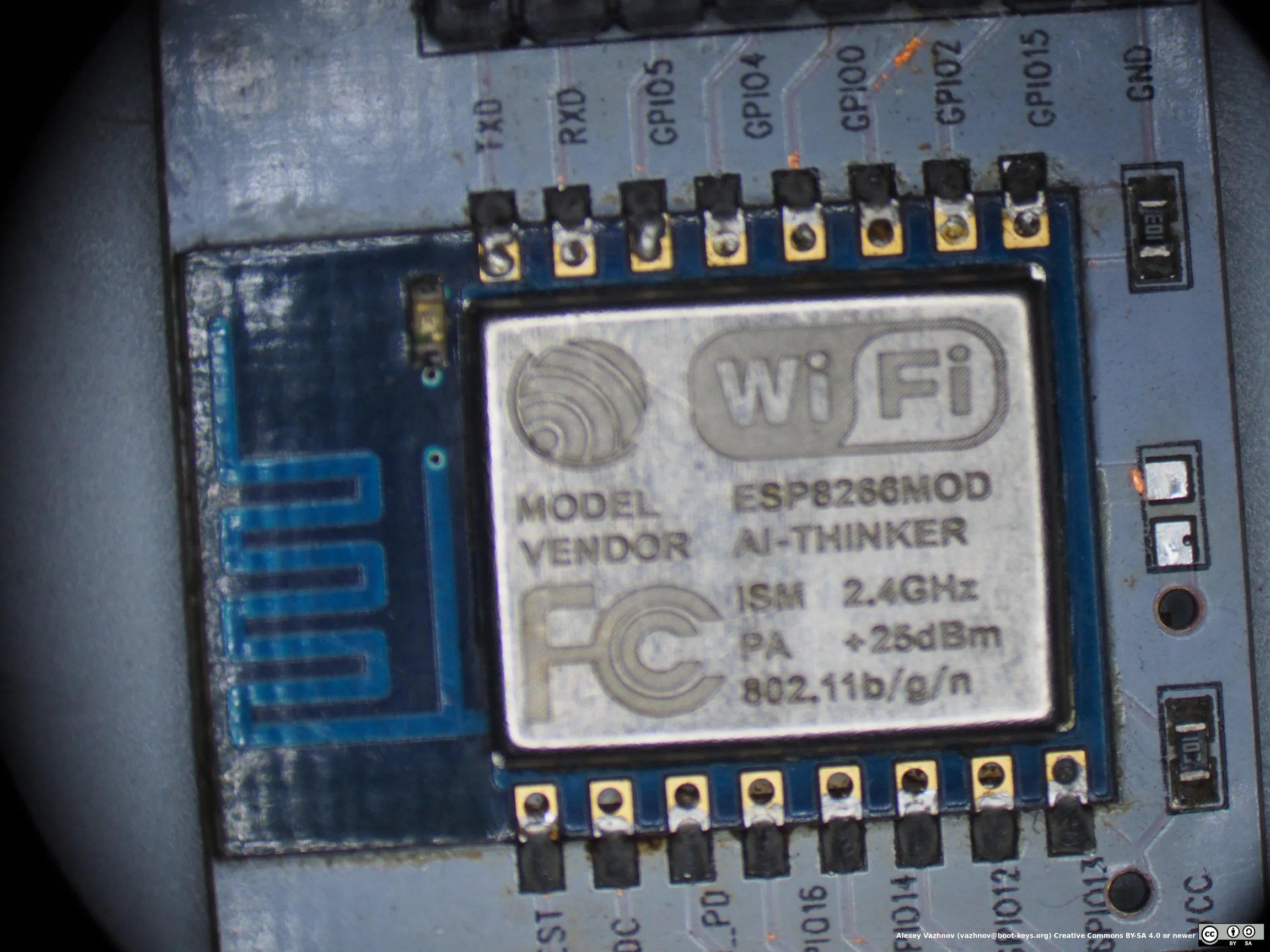

Examples of resulting photos (resized to 50% and converted into WEBP to reduce their size from 71 MiB to 3 MiB):
This photo was made, probably, with additional 0.5 lens to have wider angle:
Czy zdjęcia z takiego aparatu cyfrowego będą jakoś wyraźnie lepsze niż z tej kamery co jest na mikroskopie założona ?
I tried to use the “48 megapixel” Chinese device, photos were worse. Maybe because I couldn’t configure it correctly.
It would be nice to do a comparison by shooting the same PCBs and the same ruler.
