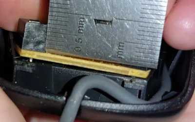

I’ve disassembled it.
It looks like both switches (left and right) are “Kailh” 5 x 7 x 13 mm. Distance between contacts is 5 mm.
